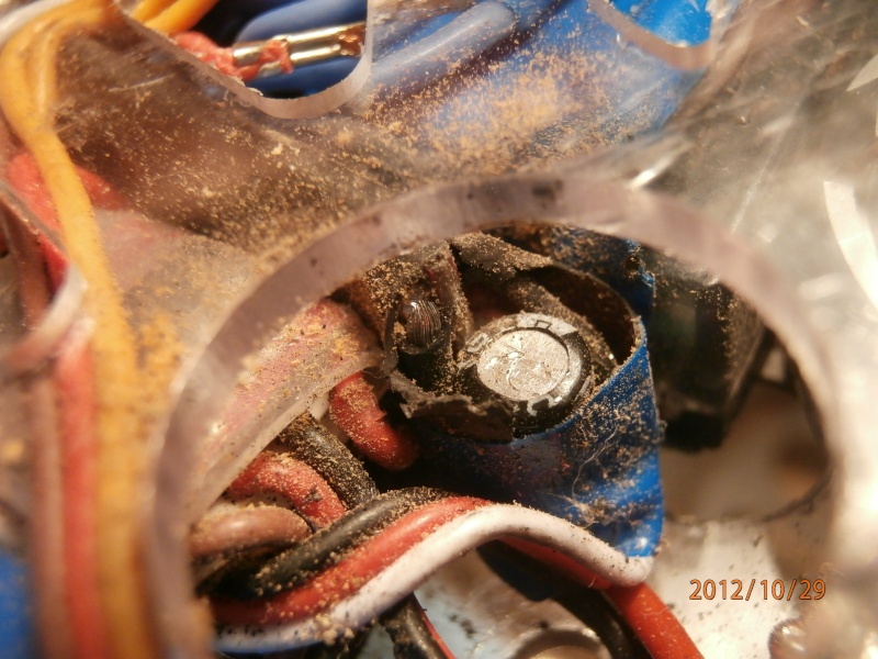

It's polycarb. Yes, it's cracking. I'm going to do some modifications on the baseplate and cut it, i'll just remove the old motor mount holes, and crew it snugly in place.
I haven't hit anything yet because I need the micro deans connector to charge the battery for it, it's waiting. That, and the motor isn't secure.
EDIT: I managed to get 1 screw through the polycarbonate. woo.
Camden's confoundations - Page 18 Pa100011
Now I need to get that battery charged...

I did a makeshift connection. It works enough to test. Unfortunately, there was a LOT of friction (more than the other motor ever had to deal with) And the motor barely got warm. I have it set to a 6 second throttle increase to prevent burning or spinning out. As you can see in the video, it still manages to really torque the bot. At half throttle.
Moar edits! I fixed the friction problem. Unfortunately, one of the servo leads on the wheel ESC broke off. It is now way scarier. I'm too afraid to go full throttle.

I re-soldered the broken lead, but since they are so pulled out, they have a very high chance of touching, which confuses it sometimes.
Camden's confoundations - Page 18 Pa100012
I can charge the battery with the JST lead still, as it's working with the makeshift connection. I don't want to attack anything yet since the teeth aren't hardened.

Unfortunately, after I shut off the video, it spontaneously went full throttle, possibly due to the throttle trim getting held (didn't notice) or possibly because of a short circuit in one of the motor ESC's. There was no controller response. I had to pull the plug while it was going full throttle. (took 15 seconds, and luckily it was upside-down when it acted up)
The motor got to maybe 40 degrees Celsius through all these charades, and somehow the belt survived unscathed. I think I fixed the belt problem XD
I can safely say nothing will fly out when it's upside-down, but those screws hurt tying to slow the inside down Shocked
So, unfortunately, this would not pass check-in. If it were to go haywire when it's upright, this is one bot you wouldn't want to touch.

Also, I have noticed the dust from the belt, and so far it's just piling up right in front of the wires, which I consider a good thing, extra protection from the belt itself. However one of the wires seems to be a little close:
Camden's confoundations - Page 18 Pa290010
Spinook could potentially incapacitate itself eventually If I keep using loose belts XD
