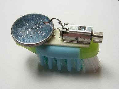

| I think my bristlebot could take your drum spinner. It's weapon, THE POWER TO CLEAN! SenaiERI | |
